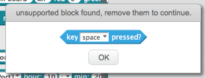

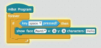

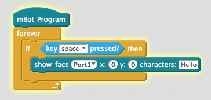

After the recent update to 2.2.0, I can’t use the “if button pressed” condition anymore.
When I try to upload to mBot, it says that the block is incompatible and must be removed.
I’m on OSX, it seem to me that the block “when space key pressed” from Events does not work. No code is created when I use these blocks.
Can anyone help?
#8
The light blue blocks in the Sensing group are Scratch only blocks and cannot be uploaded to the Arduino.
you can however incorporate them into a Scratch/Arduino program that runs on your desktop.
Only the Control, Data&Blocks, Operators and Robots can be uploaded to Arduino.
