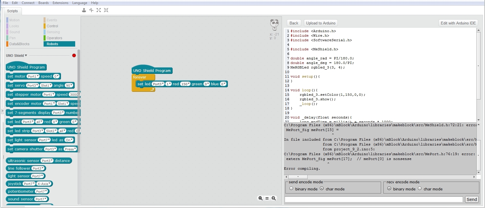

#5
Hi,
Here is the the screenshot. As I said when i use the orion shield this “program” is fine. By fine I mean i can compile it and can upload it, with a meUnoShield i can’t even compile it and the one thing what is different is the meOrion.h or meShield,h include.
With regards
Aant
#6
Hi Aant,
Thanks for your feedback on this issue.
It has been verified and the next version mBlock (which may be published on next week) will solve it.
