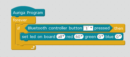

We can also use simple codes like below to check whether Bluetooth controller connected to the Auriga.
