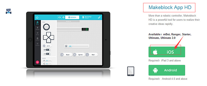

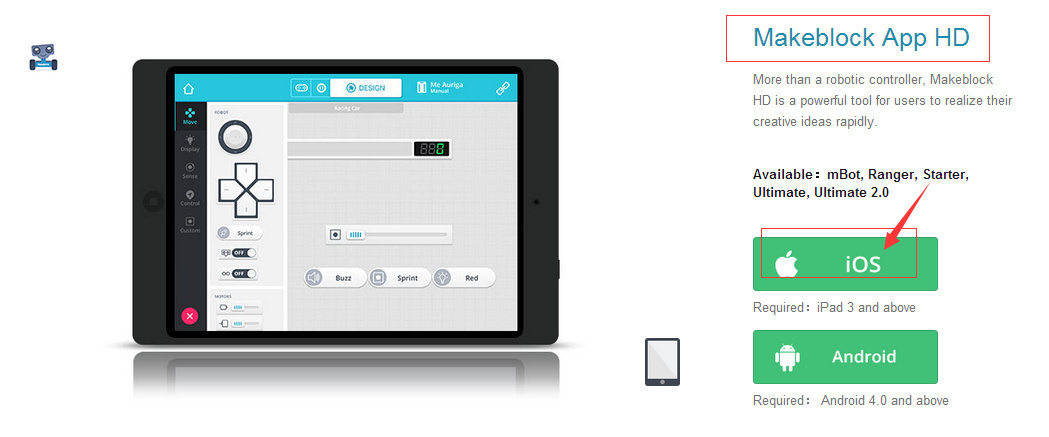

Dear verdell1,
First, you may check if you have downloaded the latest version Makeblock App in this link:
http://learn.makeblock.com/en/software/
If it is, please change the battery for the mBot have a try since the mBot may not function properly if the Bluetooth connection cannot get enough power.
