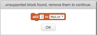

I’m writing a program that uses lists to hold data but the mBlock IDE keeps rejecting anything to do with accessing elements in a list or performing any list operation. I’m not liking the notion that I can’t store list data because the capstone program for a course I’m writing requires that capability.
Sample Program:
I get the following error dialog:

Lists do work in mBlock, just not with mBot. I’m attaching some code that demos this, Concurrent.sb2 (74.9 KB). I’m not sure why it works one way and not the other.

I’ve noticed that if I’m running tethered or via 2.4GHz wifi lists work fine with the click to start hat block. I suspect since mBlock is doing code generation under the covers that the infrastructure to handle lists is simply not there because of the way Scratch handles lists. I’ve dropped a note to support to get confirmation and I’m looking at the code on Github (not sure how current it is) to see what can be done. The biggest challenge would be to distinguish between strings and numbers because Scratch is not a strongly typed language.
Looking at your code, you’re doing similar things but when I try to switch to Arduino mode I get the error dialog complaining about unsupported list methods. Hopefully there will be a workaround at some point.

If you run the program from within mBlock/Scratch, you can have lists. However, there are no plans that I’m aware of to implement this for the code generator used for standalone programs. The biggest issue that is likely holding it up is the amount of SRAM (variable memory) that is available after the Makeblock libraries are loaded is about 1K (1024 bytes) and it is reasonable to assume that it is intentionally not implemented to avoid crashing the Arduino. Inconvenient, but understandable.
