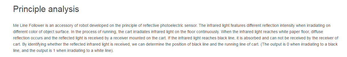

Yes, you’re right, the sensors on the line follow array can only detect white or black. It has the same working principle with the line follower sensor in this link.
Currently, we don’t have color sensor available for sell though there is plan which would take some time.
