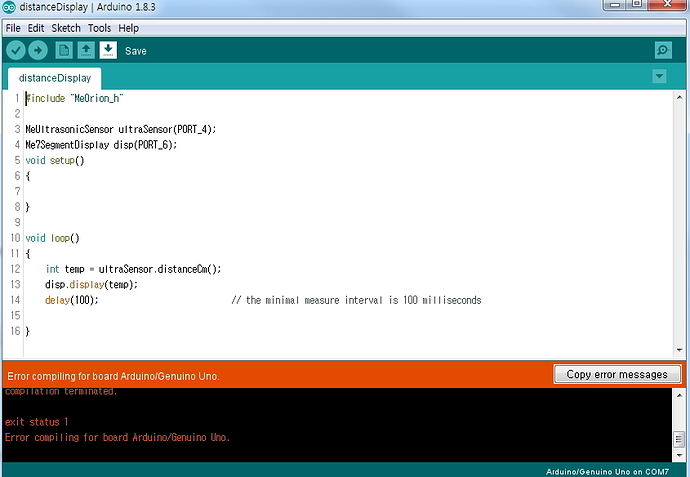

I am trying to compile and upload code.
As per http://learn.makeblock.com/en/learning-arduino-programming/
I installed Makeblock_Driver_Installer_for_window.zip and Makeblock-Libraries-master.zip.
Please see the below in my computer.
However, compiling fails and fails…
Error is
"exit status 1
board Arduinno/Genuino Uno compile Error"
What is the problem??? or any advice ?

#3
Which example program you have test?
Explore Electronics Project 1: Distance Display
which version of the Arduino software do you use?
Arduino 1.8.3
Could you advise? Thank you.
#4
Hi funrobot,
Do you use the example program in this link?
If yes, it is suggested to compile the program online through the web browser.
If you want to upload it through the Arduino software installed on your Computer, you may need modify this program refer to the example program “UltrasonicSensorTest” in Makeblock library. You may try following program:
#include “MeOrion.h”
MeUltrasonicSensor ultraSensor(PORT_4);
Me7SegmentDisplay disp(PORT_6);
void setup()
void loop()
int temp = ultraSensor.distanceCm();
disp.display(temp);
delay(100); // the minimal measure interval is 100 milliseconds

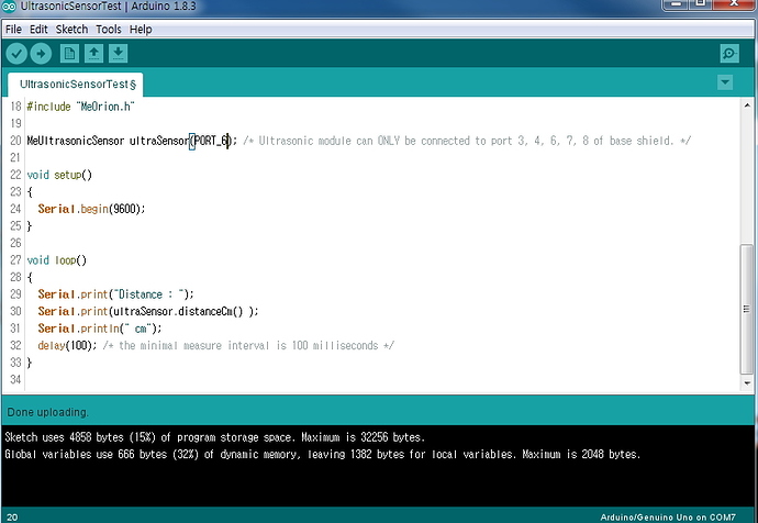

In addition,
NO PROBLEM with Ultrasonic Sensor Test…

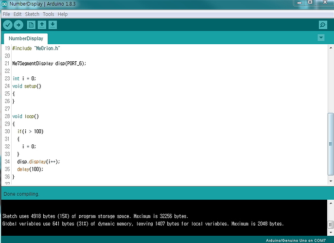

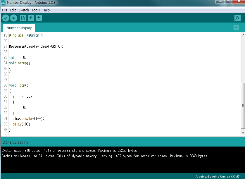

NO PROBLEM with Segment Serial Display Test…
Distance display.ino Still PROBLEM…
