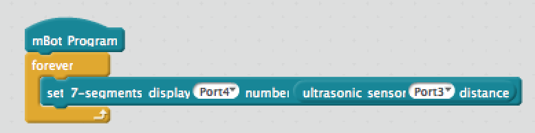

I have the 7 segment from the inventor kit connected to my mBot and it works fine.
Show us your mBlock code.
#3
#4

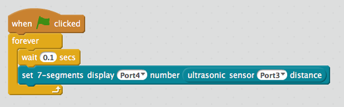

Ah! I was trying to use it connected via the 2.4G connection using a “When Flag is Clicked” program. When I tried uploading it to the mBot via Arduino mode it worked. When I went back and created a similar loop (with a slight delay so it wouldn’t overrun the serial buffer and crash mBlock) via 2.4G it didn’t work. This looks like an mBlock bug. I wonder if v3.0 will fix it when it is released for the Mac.

I’ve heard from others that running certain items in a tight loop through the 2.4GHz serial can cause crashes. Adding in a .1 sec delay does do the trick most of the time but clearly this isn’t optimal. I’d love to see some of the bugs worked out too.
The bluetooth doesn’t seem to exhibit these issues but since the calls are all going out and back data does get dropped. For testing I usually keep the USB connected but uploading to arduino and running off-line is the best way to go.
