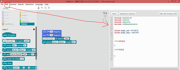

Actually you can copy and past your sketch form aruino to mBlock and upload to mBot board directly. Here is the screenshot:
Click Edit ->Arduino Mode
