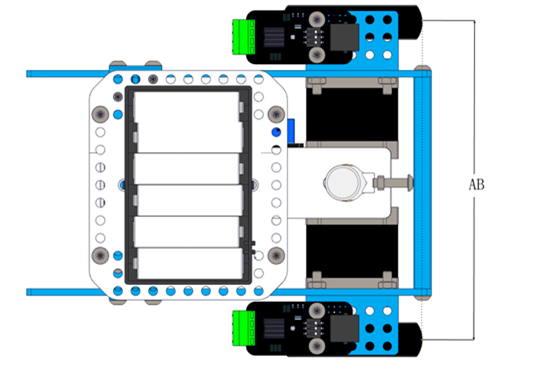

  1. Make sure the bilateral symmetry of the wheel on the left and right side. Measure the length of AB.

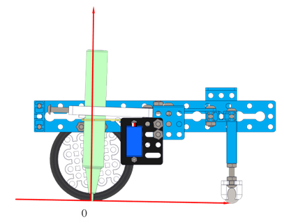

  2. Below is the side view. Make sure the tip of the pen is pointed to the center of the contact surface of the wheel and the ground. Adjust the screw to achieve this goal. (It’s crucial that the tip of the pen is pointed exactly to the center O shown in the diagram)
    The Width(mm) in the software refers to the length of AB (mentioned above), enter the length and click OK. (Make sure the accuracy of AB)
