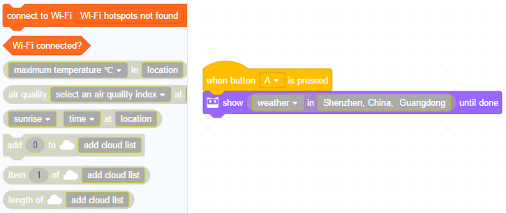

Today, I connect to the WIFI and I have a green light.
However, when I press button A, the screen remains blank.
I notice the following code is gray and it can not be changed.
The Makeblock server may not work or is broken temporarily?

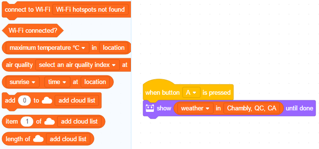

2018-07-06%2008_14_25-mBlock
But the display is still empty after pressing the A button unlike the last time.
I’m using mblock 5.0.0. beta 3.1

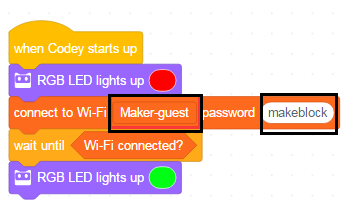

Hi Crackel,
I am afraid in your program, there is no wifi connection process, like below:
So you will know led will be green when wifi connected and it can get weather precast from the internet.
You can simply upload the example programs to Codey Rocky to have a check.
